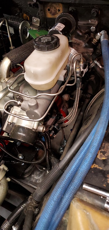

Re: Digger's '69 Build Thread
Postby Digger » Mon Aug 03, 2020 11:03 pm
Another picture after final button-up
For the soft lines, I again used the semi-rigid poly lines like before. One lesson I learn from the EFI install was the need to leave loops in the lines for easier removal. This required 45° fittings. I bought a handful of these and realized the installation tool could not accommodate 45's. In fact, I wasn't able to find a tool with a 45° adapter. So I made my own...
...and it works better than the other two adapters.
One problem I ran into was clearance issues with the standard DORMAN fittings and the fuel line stubs on the Cummins pump and filter assembly. I had a similar issue with a stock Ford EFI fuel filter, but I was able to trim off a little from the release tab and move on. This time I needed a better solution in the form of a different style fuel connector. (I found they are commonly referred to as "Bundy" connectors, but DORMAN also supplies these)
Once that was sorted out, I finished all the soft lines. About 40 hrs total for all fuel plumbing.
To me, this was well worth the time investment when I look at how clean and serviceable this truck is.
Build Thread: http://www.coloradoclassicbroncos.com/viewtopic.php?f=3&t=5420

Postby Digger » Thu Dec 10, 2020 9:42 pm
I feel like I spent most of November and part of December in the junkyard weighing options for fluid reservoirs. My PSC reservoir was not going to work. I needed something much lower profile. After searching again, I came up with a few candidates from an Explorer, an Econoline and a Superduty.
In the end, the Superduty reservoir won easily. It fit nice in the space available and had dual returns for hydroboost. I had also purchased a nice looking reservoir for the coolant expansion tank, but after mocking it in, I realized I had made a mistake since there was no place to vent system pressure above the coolant line. So back to the junkyard.
This time I found an expansion tank for a Ford Fusion that would fit. Even with a 2" body lift, the Cummins sits almost right against the hood. The coolant lines for the EGR cooler are near the top of the engine, so there is very little space above the coolant level for an expansion tank. I had to place the tank back further in the engine compartment to move it high enough.
I made some brackets and a small modification to the tank to reduce how far out the mounting ear stuck.
