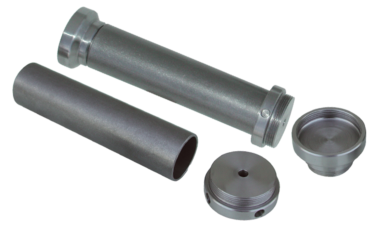

I used this kit to extend mine about an inch. You cut and weld the middle tube to set the extension length.
https://www.spcalignment.com/index.php?option=com_spc&task=part_description&pid=25603&Submit_form=Submit
I had seen those when I picked up the bump stops and was reading on them. Do you know if they are still available? Summit and the other dealers list it as unavailable. If not, I can always lift the striker pad. I also think I have a few of the 1/2" aluminum spacers that screw together, and I bet they can be modified to work. I think I'll need 2" spacers.

Gunnibronco wrote:I had seen those when I picked up the bump stops and was reading on them. Do you know if they are still available? Summit and the other dealers list it as unavailable. If not, I can always lift the striker pad. I also think I have a few of the 1/2" aluminum spacers that screw together, and I bet they can be modified to work. I think I'll need 2" spacers.
SPC quit marketing JounceShocks years ago, but they still produce them. I would give them a call and ask about that part number.
OR Bryan Kudela of Lanternmark retails SPC off-road parts on his site:
https://www.lanternmark.com/store/shaft-extension-kit
