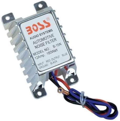

For 3 months Ive been battling an EMI issue with my stereo. I have been back and forth with the manufacturer and we went as far as replacing the head unit. I am at a complete loss as what to do next. Its an issue with the ignition system/transmission.

ZOSO wrote:For 3 months Ive been battling an EMI issue with my stereo. I have been back and forth with the manufacturer and we went as far as replacing the head unit. I am at a complete loss as what to do next. Its an issue with the ignition system/transmission.
Assume you have tried a ground loop? also have you tried to move the stereo ground to somewhere near or on the frame?
I have some experience with noise and signal conditioning. I can give you a hand with that when this COVID thing settles down. Is the head unit integral or is it a separate head unit and amp?
Have you tried a noise suppressor?
Yes tried it all. I have an idea whats going on but its too long to type out what I have tried.
Yup. actually have 2 of them on both power wires. amp and head unit are separate.

ZOSO wrote:
I'll assume that means you tried one of these?
I can throw an O- scope on it later. Either we can track down the noise and deal with it or build a custom filter to knock down the noise.
This is what I have installed.
https://www.amazon.com/Pipemans-Install ... 299&sr=8-2
Short story is I only have issue on Bluetooth and/or SD card playback of music. The music play back skips with ignition cycles. The FM radio works great. I have bench tested everything and it works fine. It has nothing to do with the wiring to the stereo. I took a spare battery and placed it on the floor. Hooked just the stereo to it and added computer speakers to the head unit. That left me with the stereo physically in the bronco(not mounted just resting) but completely isolated from the bronco power/wiring and still had an issue.
This is a video of what is happening.
https://www.youtube.com/watch?v=lyaa38q59iA
