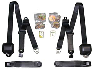

I removed the Corbeau 4 point harnesses and installed the regular 3 point retractables from WH. What a difference! These actually work great. The use the stock seat belt holes on the floor and you only need to drill one 1/2" hole about 35" up on each side of the cage. The buckle comes in a hard-plastic sleeve that you can bend and puts the connector right in the corner of each seat.
