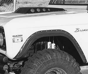

Scoop (without the holes for now)...

Scoop's gonna look cool, but what happened to your block? Looks like it's got hives or somethin'... bumps all over it... :)
