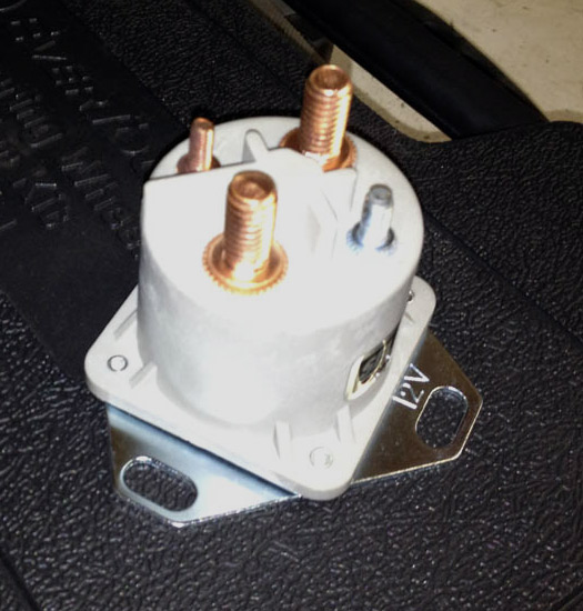

well i went ahead and bought a later model solenoid. I just asked for a 94 bronco one.. which is probably the same as the mustang and a million other cars...
I guess i should order up the ends of the cables and then I can get started wiring some.. ordering my EFI harness right now.
if anyone has insight on the charging system let me know!
