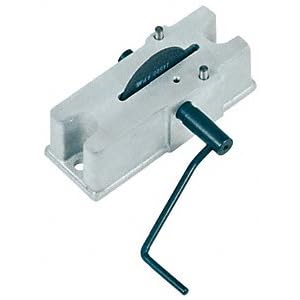

Didn't get much done as I'm waiting on the piston ring grinder to arrive...but I did get all the oil rings and retainers on.

Got 4 of the pistons assembled with rings. So far every single ring has needed the gap widened. That ring grinder works fast! One ring had zero gap and it only took a few turns of the wheel to get to .020. I plan on finishing the other 4 tomorrow and then installing them.

I finished sizing each of the rings and installed them on the pistons. Then I pulled the caps off each, installed the bearings, cleaned and lubed them up and inserted all the pistons into the block. Each one got a little easier but it was messy with the oil and lube. I decided to use a small oil can pump to coat each piston.
