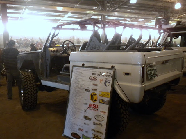

The Bronco is going to be on display tomorrow in Denver at the Toys For Tots event. This is being held at the Jefferson County Fair Grounds.
The cage is back in, along with a few other goodies and it has a fresh set of meats on it also. Go check it out and let me know what you think.

Got any pics of the Bronco from today? Those of us who spent the day with their Mother-In-Laws and could not attend would LOVE some pics laughing2

That's the sickest cage concept I've ever seen. Love the integrated dash and controls. I think that cage is worth more than my whole truck...ha! Nice work...can't wait to see the final version.

Yes, that cage is awesome, but no Entourage, no new pics. The Bronco is far from done, it is sitting on 37's and the cage is bolted in but with only 1 bolt per corner, seats are in but no harnesses, no radiator etc. You have everything we copuld picture here in this thread. Let me tell you, that is going to be one seriously sweet rig when finished. And you all can purchase raffel tickets but it is going to live in my garage.... just like all those winning loto tickets I have purchased over the years...
