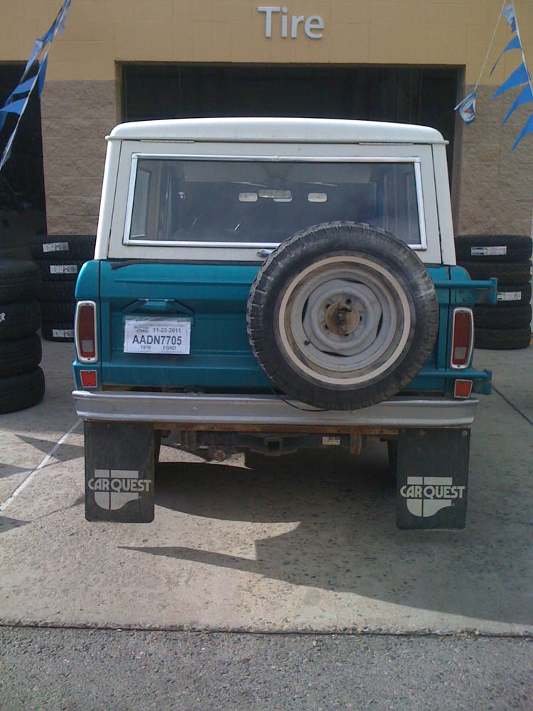

I would like to get moving on changing my Bronco to something more trail ready. This is all I know about the Bronco so far: http://tinyurl.com/6ps3y9z Not much as you can see. I would appreciate some ideas about enhancing the following areas: (starting with areas I want to change first)
Let me know if it would be easier to have a couple pros poke around at it.
Front and Rear bumper: As you will see both the front and rear bumpers are in great shape, but they are not my style. The rear bumper was fabbed and I have no idea what they were thinking. I'm looking for something more tubular or similar. I will be selling the bumpers once I have them replaced. (and yes, those are studabaker fog lights)
Suspension: I would like to lift this Bronco up some. I believe the current suspension is 2.5 inches and I would like to see 4-6 inches. Any thoughts on the current setup or a good upgrade?
Axles: I believe the following pics indicate a dana 44 front end with a 9 inch rear? If not, what are they?

Yeah, you've gotta do somethin' with those bumpers.
You pegged the axles, and unless you want to do anything major/heavy duty with tire size (37+) I wouldn't change your axles.
Lift, there isn't a 6" lift unless you use a combination of suspension & body, and I wouldn't recommend going too tall anyway. I've got a 5.5" suspension and I pick up some body roll that I don't particularly like. I think a good height is either a straight 4" suspension or a 3" susp. + a 1" body. But again, I'm not keen on body lifts. As for what lift to go with, WH, BC & Duff all have great lifts and you can't go wrong with any of them. But I might hit up Clint at Battlement over in Grand Junction to see what he has rolling around in his head. Me thinks he might be able to help you out with something pretty cool that he is working on.

Changing those bumpers would be a priority for me too.
I would also recommend converting to EFI as the carbed motors want to vapor lock at altitude. If you don't want to convert to EFI I would absolutely recommend converting to an electric fuel pump system as other have done.
Unless your wanting to dive head first into wheelin it..............I would drive the ol girl around this summer as is to learn it's particulars and determine what might need to be done vs what you want to do.

i second ditching the bumpers and probably one set of rear shocks.. i bet without all that weight on the front and back it will raise up a bit as well and give you a bit more clearance.. those things are huge and I bet weigh a ton!
you can probably lose the mudflaps.. or let the next trail take them off ;)
I also recommend you wheel it a few times to get a feel for it and see what improvements you want to make. The nice thing is it seems like a great truck that can be wheeled now while you take stock of what you have and make little improvements along the way.

This all depends on how serious of trails you want to conquer. I'll bet it's fairly capable as of now. Probably could handle 3-4 rated trails with some experience behind the wheel.
Bumpers - You want your bumpers to improve approach and departure angles. Those stick out a mile and you will hit them on everything! Plus if you get them both dug in, you could be in trouble. I see you have a winch, so you want that integrated into your front bumper, but you want that winch mounted as close to the body as you can. For the rear, consider integrating a tire carrier. The stock tire carrier will not hold up with 35's and on the trails. You will tear your body. Again, you want it tucked in as much as possible. Don't be afraid of cutting frame horns off to get them tight to the body. I'll post pics of how mine have turned out if you're interested.
Roll cage - if you don't have one, it's a good idea. A roll bar is ok for mild trails, but you'll need something more sturdy for moderate to difficult trails.
Suspension: - I have 3.5" suspension and 2" body. It's a great combo for me. But I have done extensive modification to my drivetrain to get a flat belly, so nothing is hanging below the frame rails (which necessitated the body lift). I have an 11-leaf spring pack from Tom's Bronco Parts and they flex great and ride pretty nice. My front coils are crazy stiff, but I don't think you can go wrong with most of the vendors out there now. I have some of Clint's stuff on my rig and I'd also recommend talking to him. You may also get by cheaper by piecing the lift together. One thing to consider in Suspension vs Body lift, is a body lift doesn't raise your center of gravity as much as a suspension lift. But I wouldn't go more than 2" of BL. You want a suspension that flexes well, which equates to rig stability. You can control body roll with a sway bar if it bothers you.
Axles: It's been a long time since I have looked at a stock axle, but what is the bracket hanging below the tube on the passenger side? You'll want to remove everything that can get hung up on a rock. Your pumpkins are hard enough to maneuver around.
As others have mentioned, you should address your steering. That is a horrible thing to break way back in the woods.
And since your bronco looks really nice, consider protection. Namely the rockers. Those seem to get crunched first, but before you get too serious, protect the body because it only takes once to ruin body panels. You might look into tying rocker guards into front a rear bumpers with hoops over the fender wells. It gets hard to support the hoops, but those seem to be the ones that get damaged first.

Yes, we all agree 100% the front and rear bumpers need to go. Not only are they not my style they must add a lot of weight too. The seller claimed he had the Bronco weighed 3 times and it showed 5700lbs with no one sitting in it. I'm not sure if the guy is nuts or if the Bronco is just portly with those bumpers. Zilla, I would love to come take a look at your bumpers and maybe discuss the current state of the Bronco. I will send you a PM.
For the suspension, I will call Clint to see what he has to say. I hate cold calling people but I will do it just the same. Otherwise I will be purchasing a WH 4.5" lift and then some 35" tires and rims once the lift is installed. It's a heavy beast with that 351W in it so that 4.5" suspension may only give me 3.5-4" when it is all said in done. I'm going to need either a good shop to install the lift for me or some volunteers to help out. I don't have a garage and my tools are limited at this time so I don't have a lot of options. Not to mention never doing more than a shock replacement on previous rides when it comes to suspension.
An EFI swap or upgrade will be in the future, that may have to wait until Winter or sometime next year depending how things go with $$. I will need help figuring out exactly what 351w I have and what condition it is in before I decide on swap or upgrade. Also, I want to be able to drive it as much as possible this Spring-Summer-Fall so staying out of the engine until Winter is my goal. Unless I need to fix something or make an easy change for big gains. Then again, I'm not totally against a carb setup as long as I can get it dialed in. I will start hunting around for quality parts with HP and Torque gains when I decide.
Mudflaps! I've been meaning to remove those. I bet the cars behind me are thankful for them. =)
