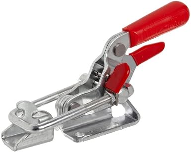

I'm a proponent of cam latches. When I built mine, I was in a hurry getting ready for Super Celebration, so I used a De-Sta-Co clamp I had laying around. Not as convenient as a door latch, but its rated for 3000 lbs and doesn't rattle.

The De-Sta-Co latch was on my list as well (mcmaster carr) and it would be the cheapest way to go.
