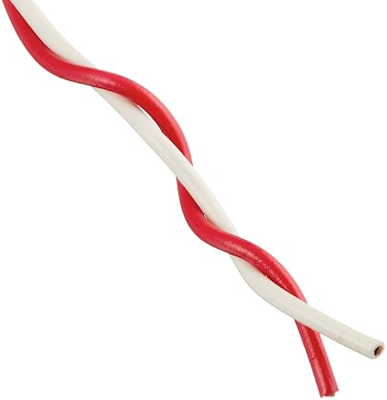

However, I don't think the back firing has anything to do with compression. If you are seeing sudden and random changes in ignition timing, there is likely an issue with the ignition trigger. The trigger could be bad, the wiring may need to be better shielded or the gap between the sensor and trigger wheel adjusted.
Can you tell us more about the ignition pickup?
- Is the sensor 2-wire or 3-wire?
- Is the wiring exposed or encased in a shielded conductor?
- If not shielded, is the wiring twisted like this?
From experience with my Megasquirt system, I had a bad ignition pickup and it would cause the computer to register multiple phantom ignition pulses. This made the computer think the engine was spinning faster than actual. (6000 rpm vs 700 rpm actual) The computer reacted by pulsing the injectors a bunch and advancing the time a lot.
