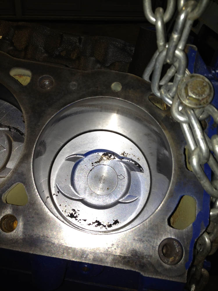

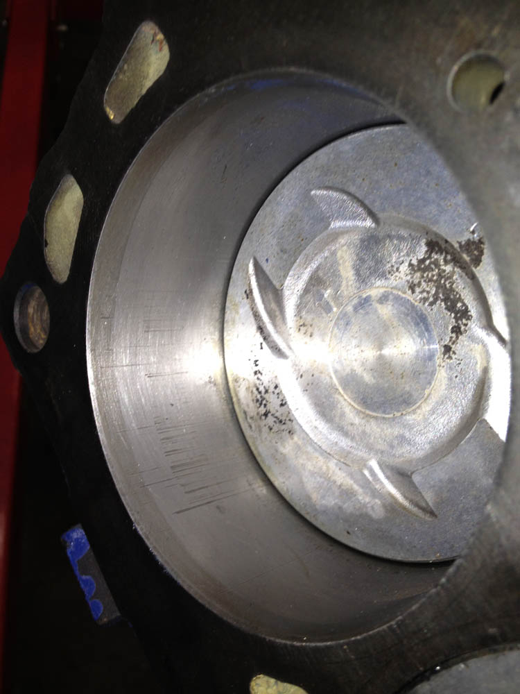

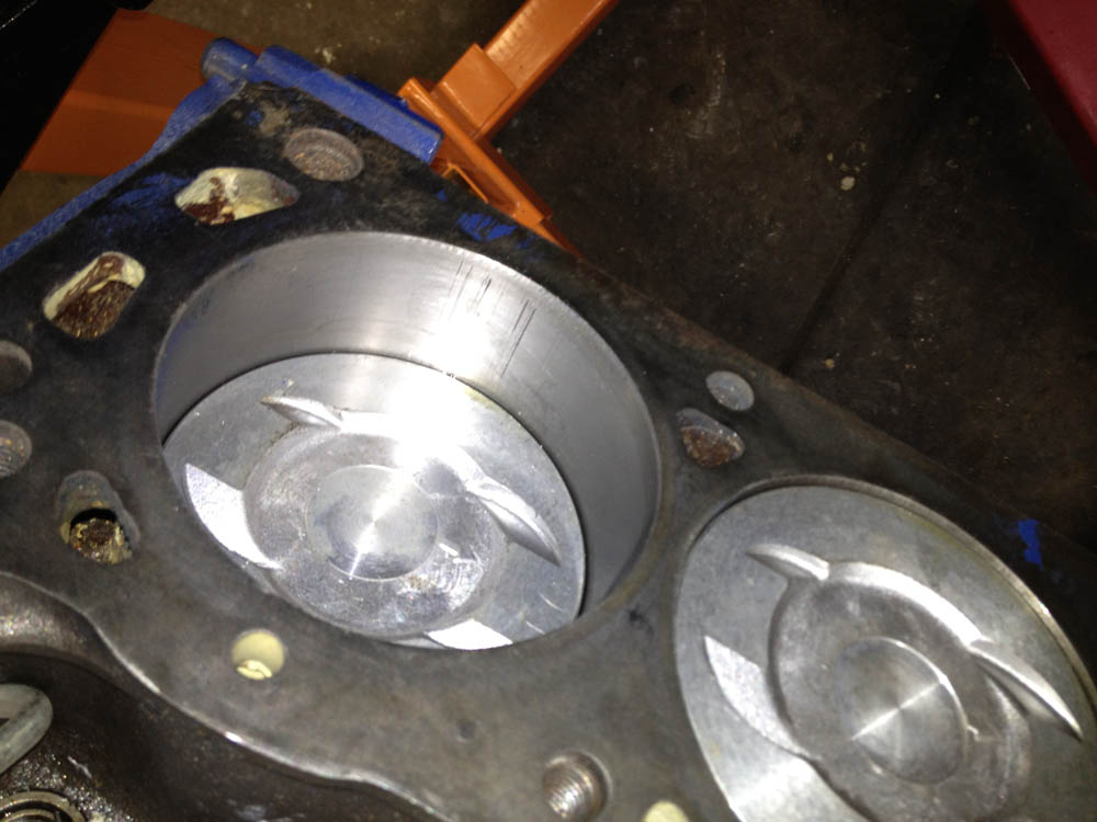

Not being an experienced engine guy i have a question or two about one i recently picked up.

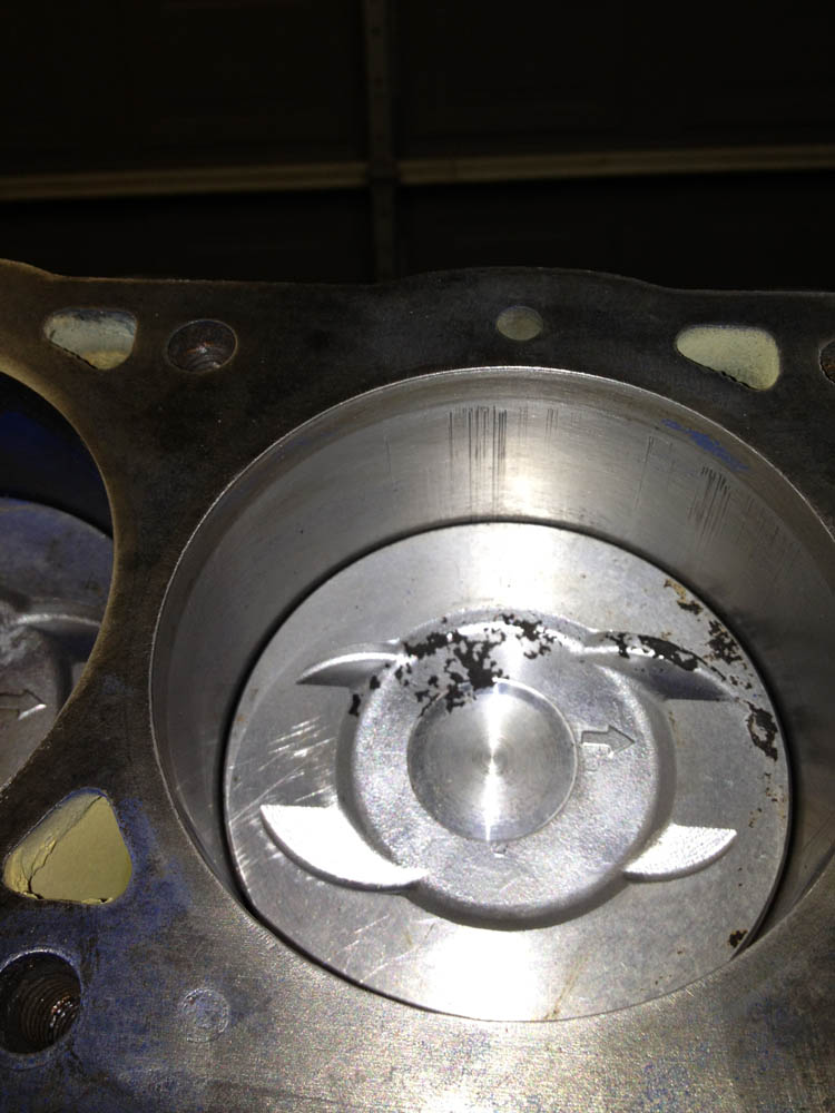

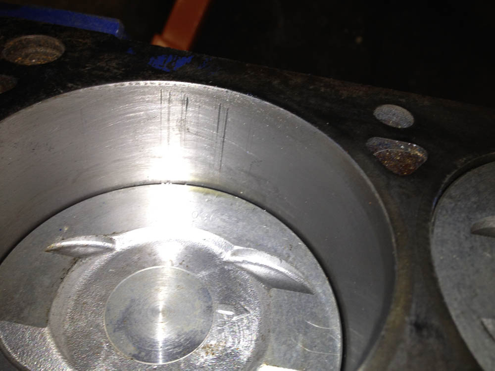

The engine has been re-bored .30 over, cleaned up, new cam, timing chain, bearings etc.. upon inspection of the cylinder bores however there are vertical scratches... some are short, some are long.. most I cant feel with my fingernail however there are a few that are deep enough to catch my nail on.. I assume this is bad and will result in a smokey oily mess... I suspect the .30 over was done some time ago and it was recently honed.. which wont really help in the long run.
It does have TRW pistons and an RV Toquer cam (no idea on what kind yet)...
anyway I took a few pics and need some opinions from the knowledgable crowd out there... is this block a paperweight or will this be ok to run?

Look elsewhere. That thing should be spotless if it was just bored. Also, why did they put the old pistons back in? Is everything else in there used as well...rings, bearings etc ?
I'd just dump it or take it to a real machine shop and see what they can do.
Tue May 29, 2012 10:52 pm
Post Re: Cylinder wall scoring - bad news?
It can be bored but might not clean up until .060" or more over. If any of the scratches are more than .015" deep consider it a boat anchor.

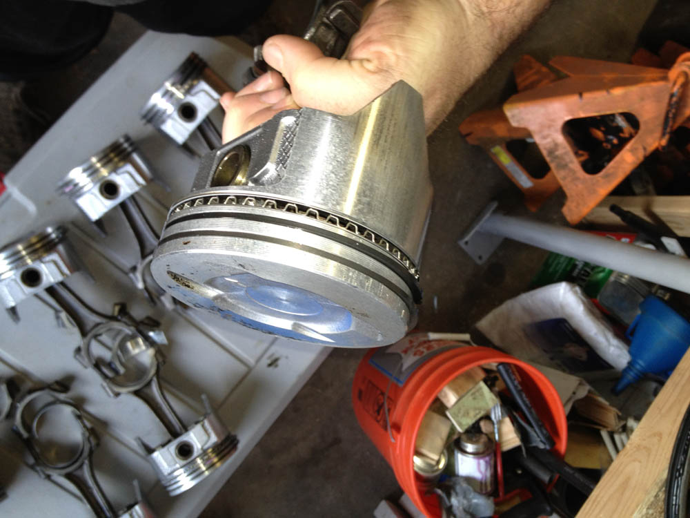

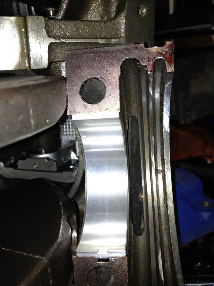

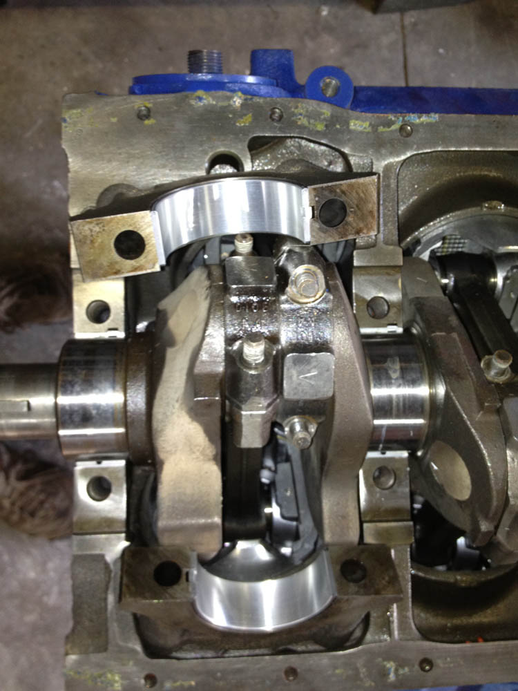

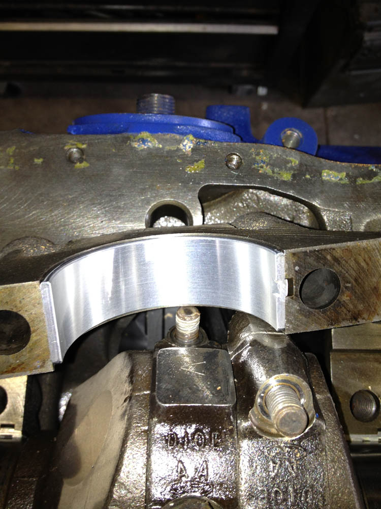

Good plan. That 5th picture scares me....looks like they had sand in the oil. I wouldn't trust any internal part of that engine (including cam).

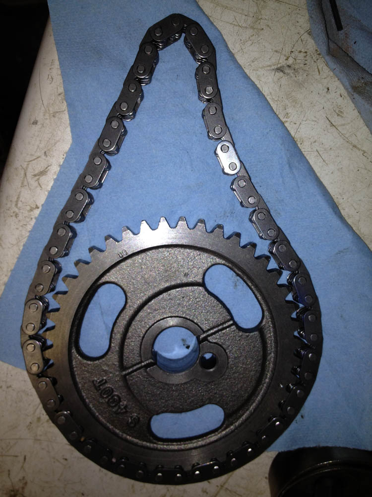

looks like the timing chain and gear is new? There was NO play in the chain not even slight movement...

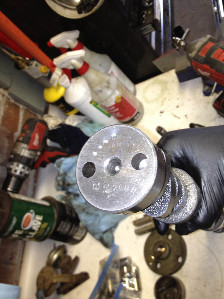

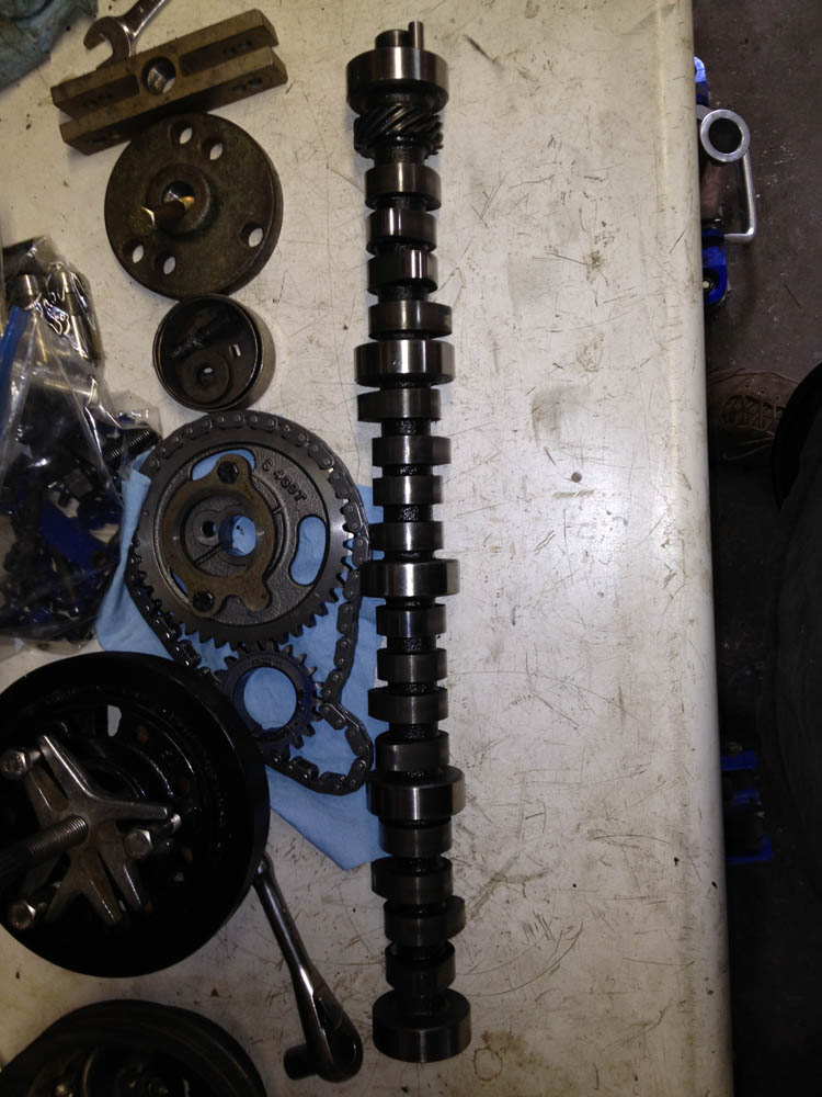

Pulled the cam, looks like a Comp Cam 260h, which i guess is ok if your running a close to stocker engine... i looked pretty close see no scratches or scars.. a few light scratches.. like very like.. can't feel them..
is there something in particular i should look for? its definitly been ran i can see the marks on the outter lobes.. but other than that it looks ok?

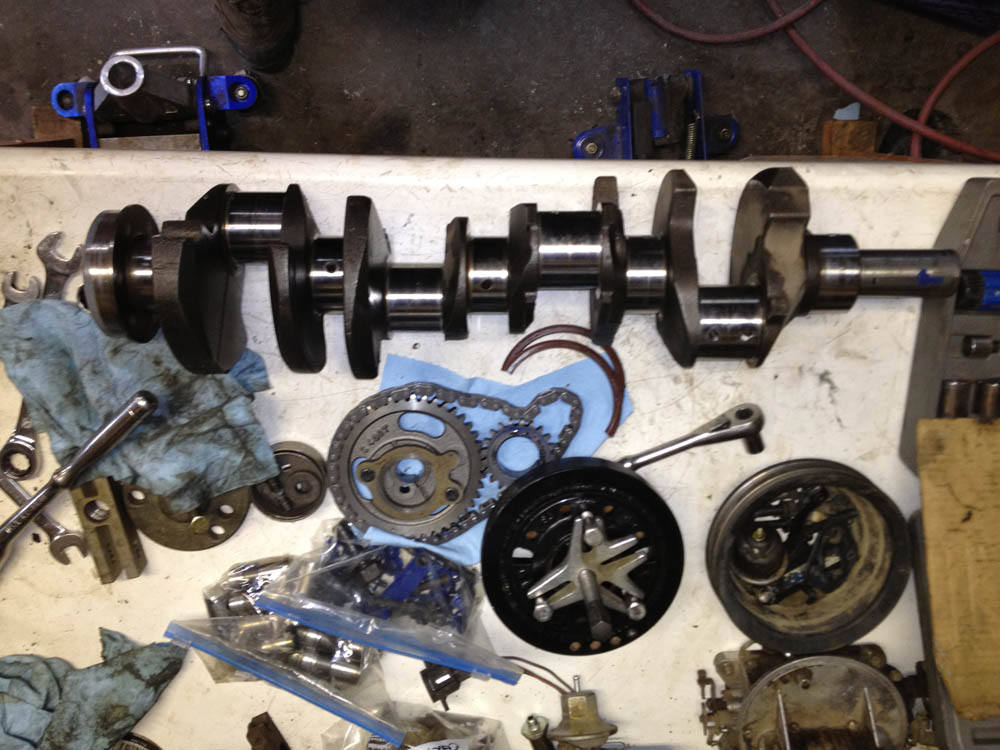

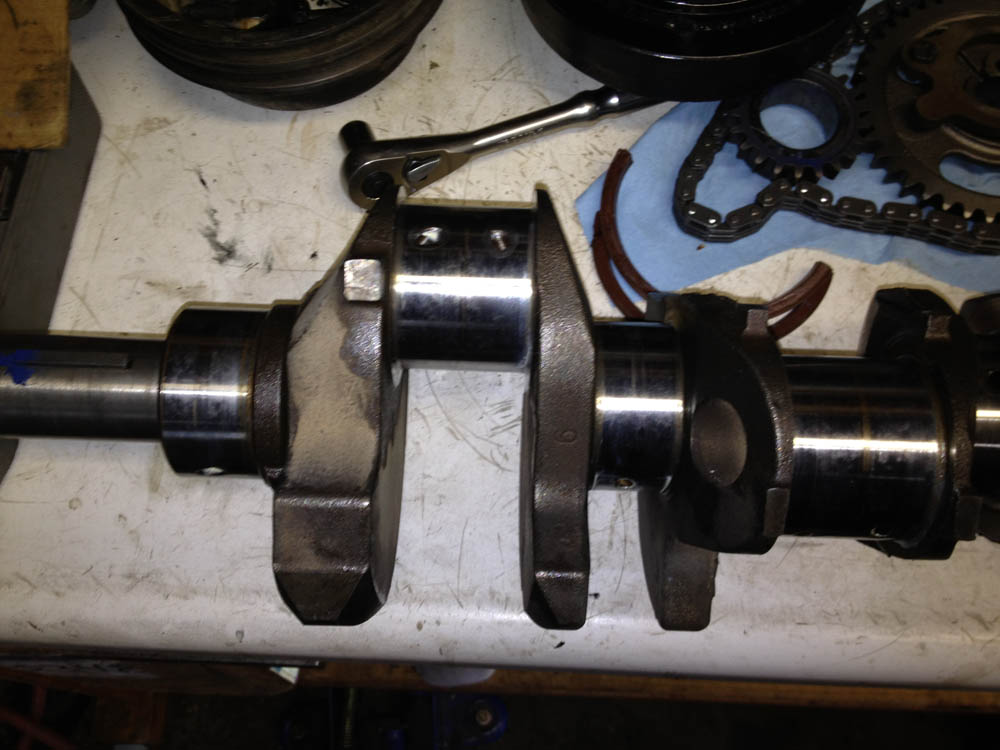

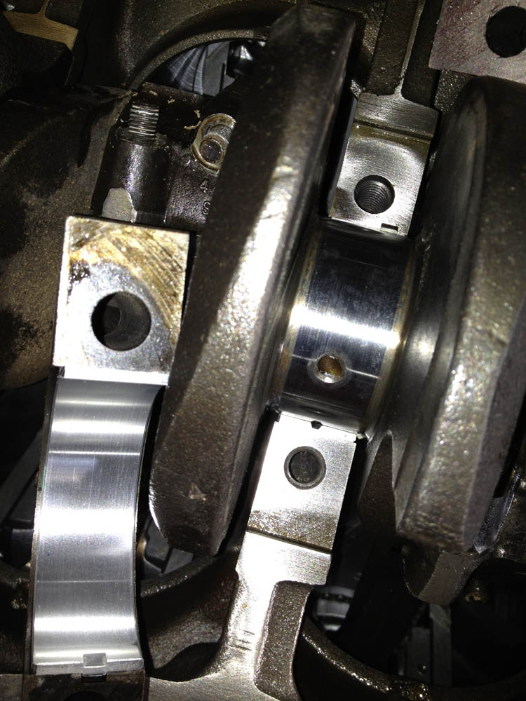

Pulled the crank next, looks like the races (if thats what you call them) look brand new...
picture of the crank...

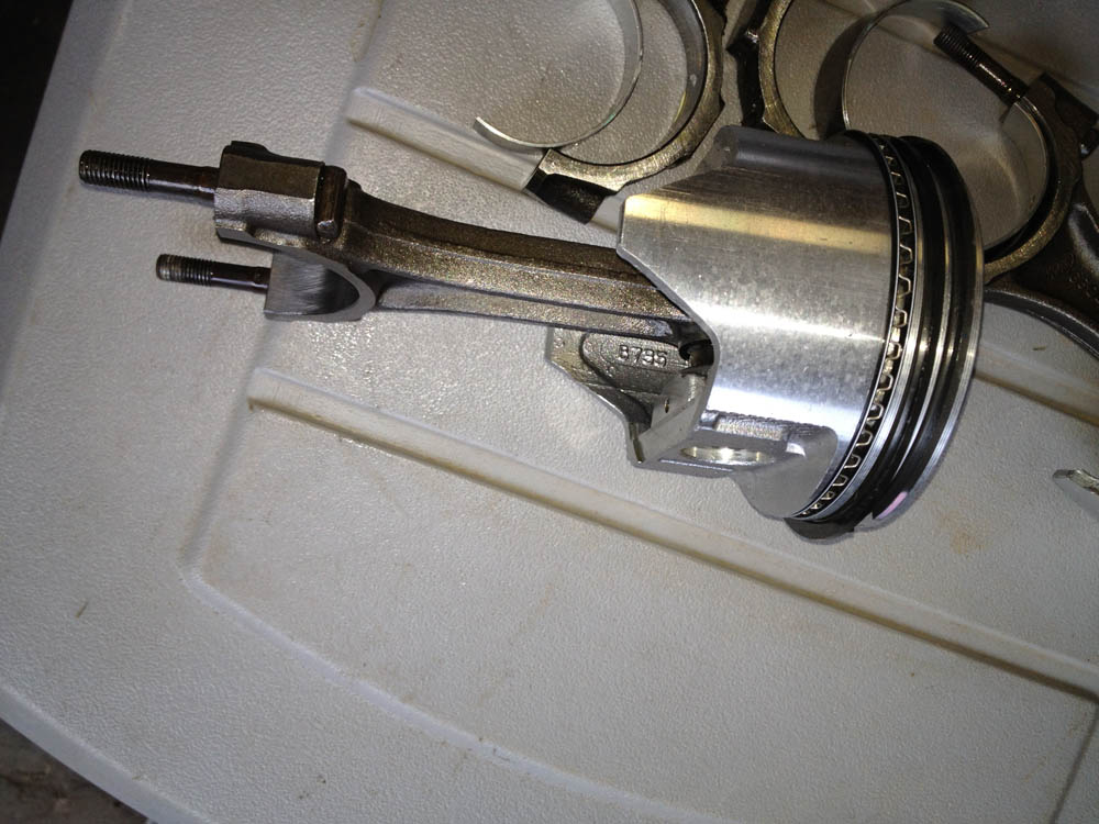

then i pulled the pistons.. not sure if they are used or not.. rings look like they have never been ran.. wont bore you with images of all of them..
thoughts?
Wed May 30, 2012 8:13 pm
Measure the bore. Looks almost like they just pulled it apart and cleaned the pistons. Re ringed it with new bearings.

so i could use the cam and timing chain in my 78 block then junk the rest?

Don't leave the crank laying on it's side. Causes it to bend. Bolt the flywheel/flexplate to it and stand it up or leave it in the block supported by the mains.
If the cam is used and you reuse it did you mark which lifter went to which lobe? Can cause the lobes to go flat. Check the lifter surface with a straightedge and see if you see any dish to the lifters if so replace em.
Most pistons I've seen have the overbore size stamped on the top. Like Zoso said it might just have been honed and maybe new rings and bearings. Look at the back side of the bearings it should have a number like 10 or 010 or something if crank was turned.
I've run a few engines that we just removed the ridge at the top of the bore, new rings, bearings and seals (not new cam bearings), hone bores, clean pistons and go. Is it going to run 100k miles probably not but it will get from A to B. It'll run and might use a little oil but shouldn't be a mosquito fogger.

Why are the pistons painted blue on top? That scoring is no bueno. Sorry man!

Chris about the cam and lifters - you would be better off just buying all new than keeping a few.
