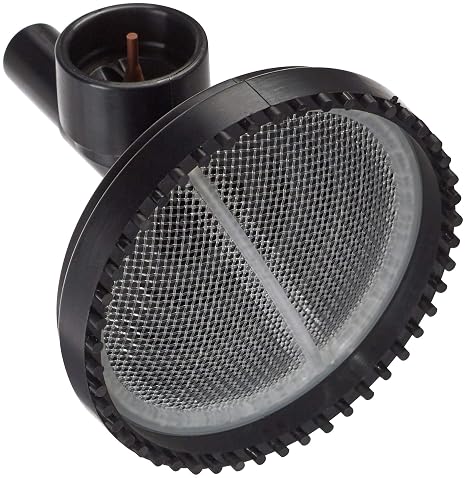

To address the plumbing, I ordered a fuel pickup stainer and a tubing bender set.

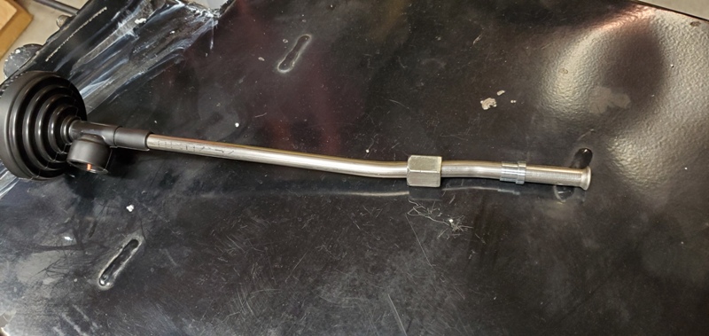

I broke out my tubing straightener and roll of 3/8" stainless:
Straighten a section out:
And built a new 3/8" fuel pickup tube with a 37° flared end:

I started to "geek-out" a bit building the hard lines, but I've been looking forward to building single-piece stainless lines vs the old pieced-together steel lines I had before. The brakes started with a roll of stainless and the tube straightener.
I reused the fitting nuts off the MC and flared the new lines.
Fitting the pair with the new bracket and flex lines turned out pretty well.
With the old brake lines pinched off, I started pulling the old hard lines.
In my previous work, I made plastic hard line brackets. At the time, I forgot about the ARB air lines and they ended up zip-tied to the brake lines. This time I wanted something better, so I made new line clamps with four holes.
