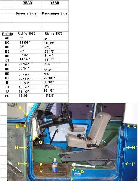

Any suggestions for that DS door post? I tried to get it back to the position of the original door post but I think it is cockeyed! let me know what you think. I will take a picture and show everyone what it looks like.
Thanks

Thanks for the info...I am heading out to give this a try.

Got the quarters in the mail on Wednesday and test fitted them. They fit pretty good. My rocker alignment may be off a little but I had to press the lower part of it in to get it to fit between the rocker and door post. Anyone else have this issue or is it just me?

I was actually able to get inside the fender with an extension on the drill. Got the driver side quarter almost finished up today. Gonna try to get the passenger side fixed up tommorrow.
One thing I'm not too excited about is the height of the skin. It doesn't line up exactly to the rocker or the tail light.
