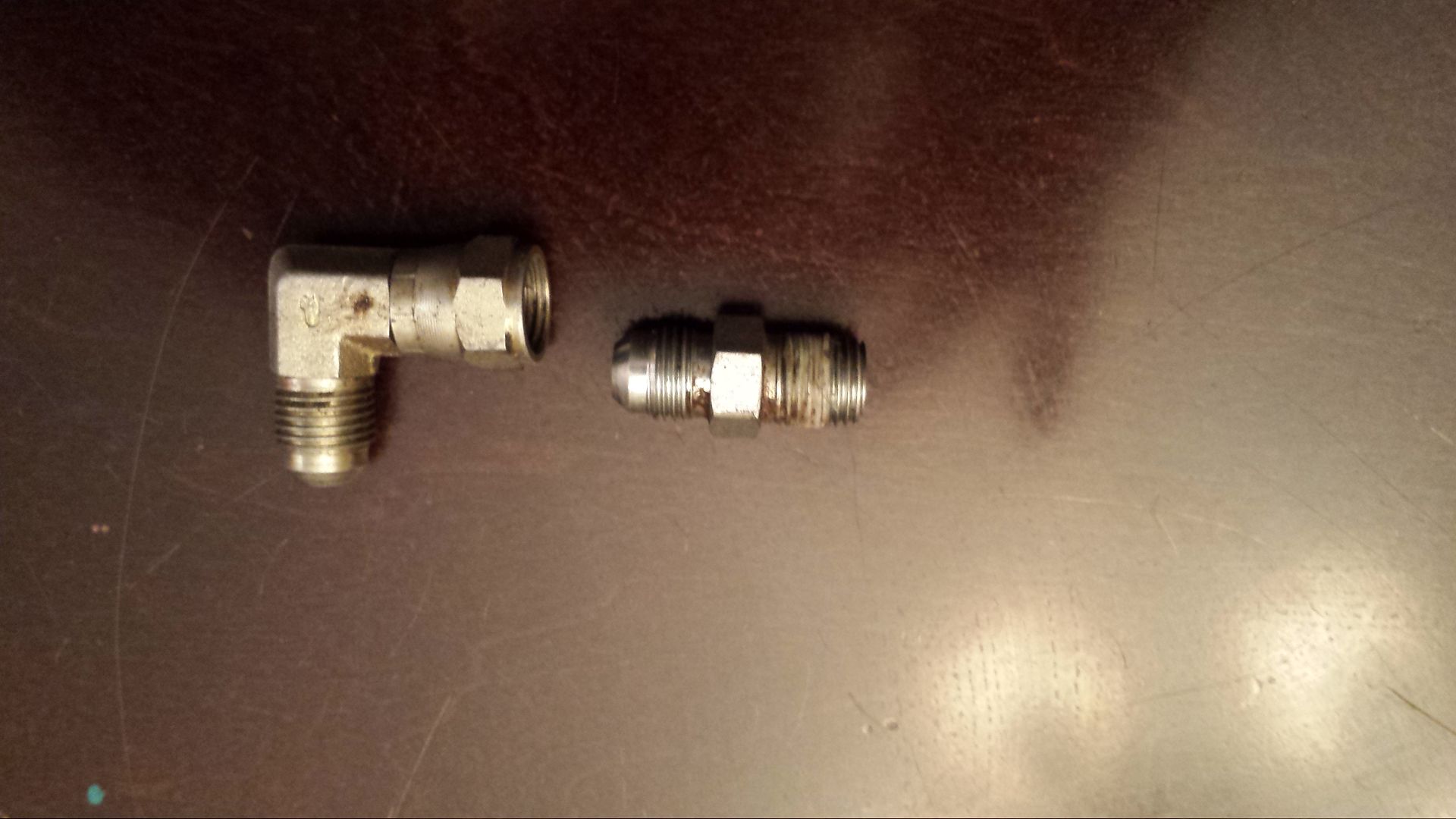

Post Re: PS hose with 4x4x2 box
Mon Jan 06, 2014 9:27 pm
Joined: Wed Jan 26, 2011 10:55 pm
Mon Jan 06, 2014 9:28 pm

That looks like what I need! Where did you get that 90?

Now that I look at it again it needs to be inverted flare.

They should work for you. . There free so you haven't lost anything. . My parents live in hr. Text me your info I will have him bring them that way

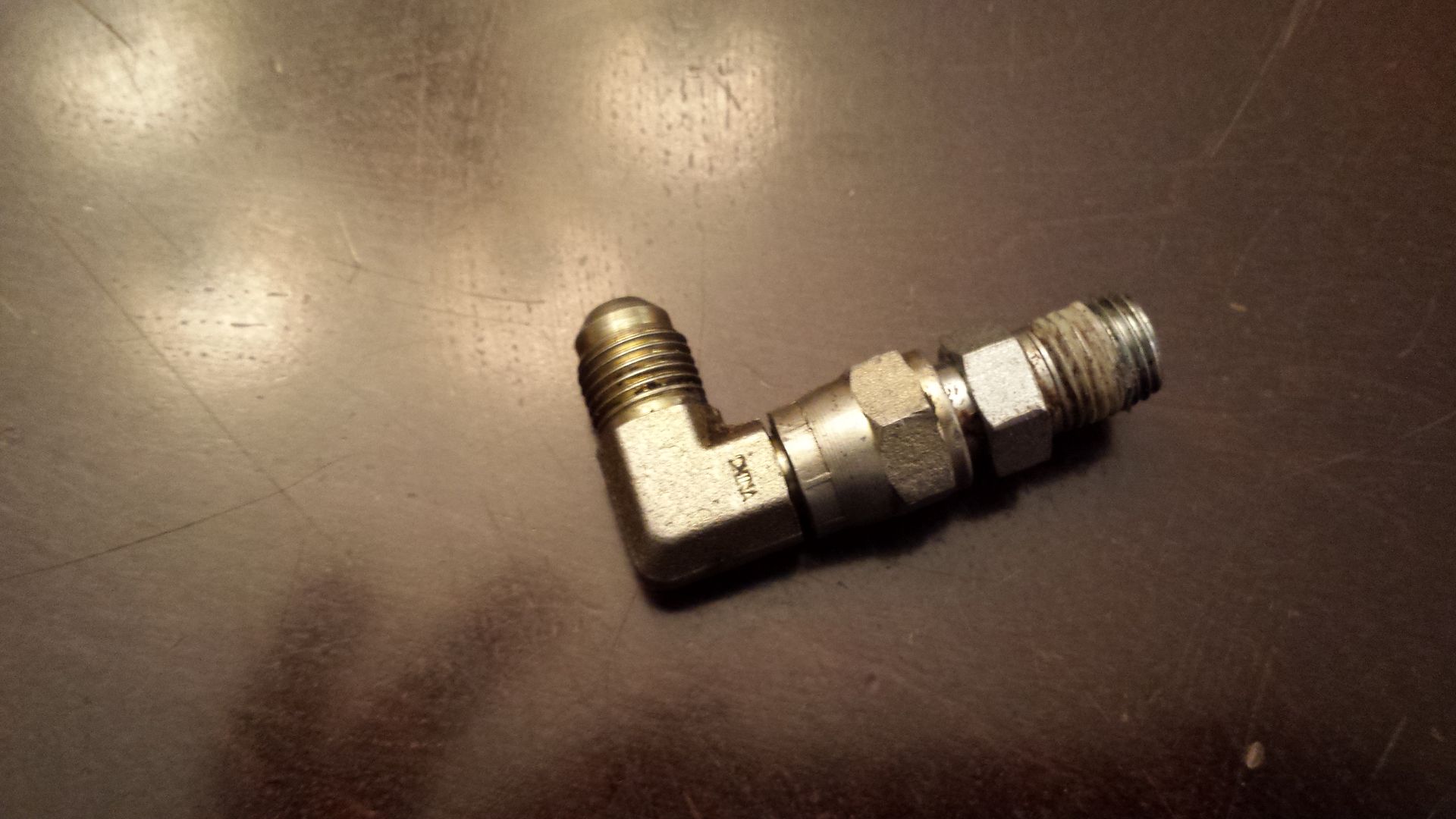

These will attach to the blue an fittings and swivel anywhere you want .

Thanks Trei, I just sent you my info. Is that 90 -AN on both sides? If so then yes that should work great.
