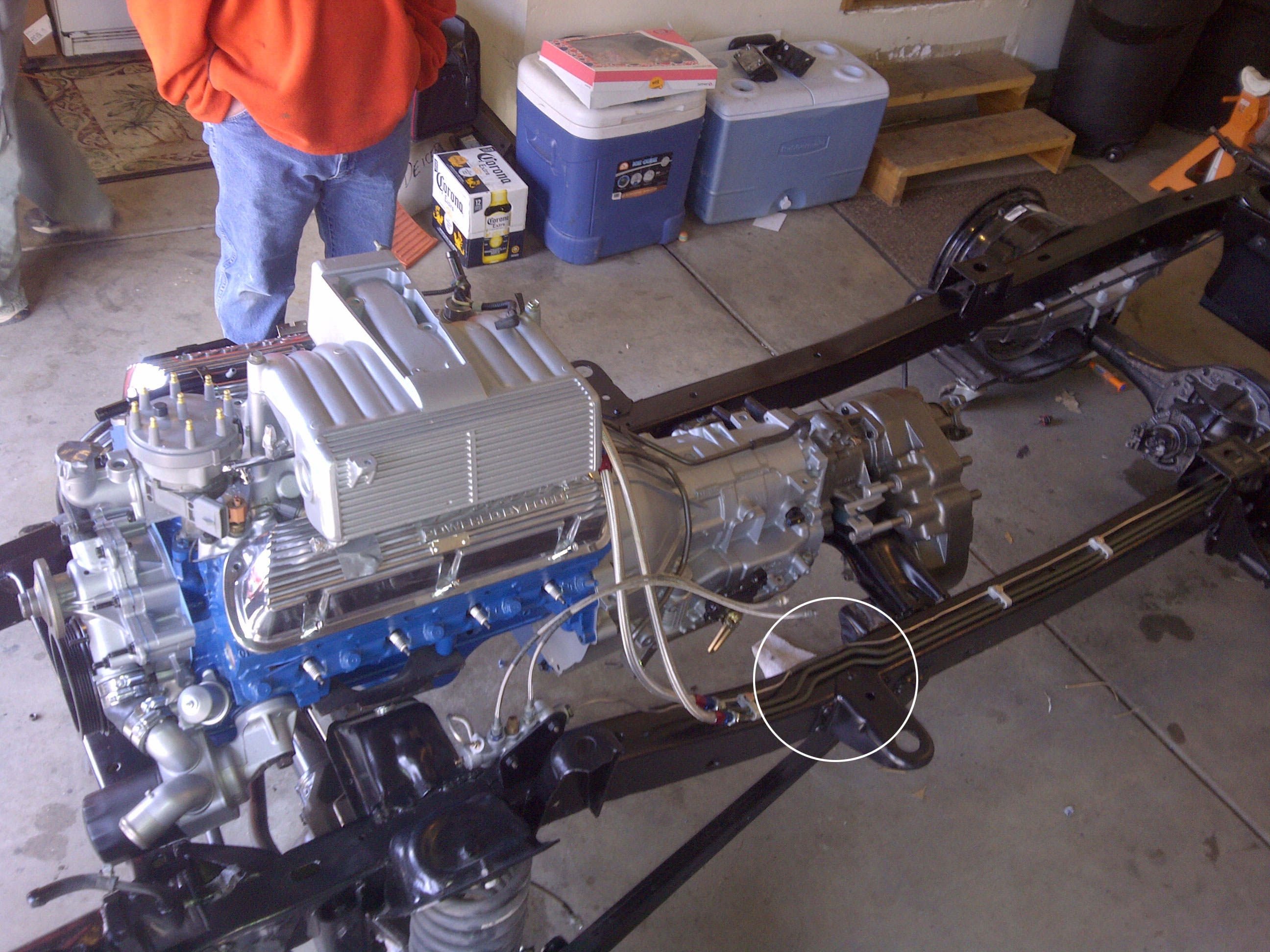

is there some reason you bent those lines around the body mount area? i assume your not doing a body lift.. but it should still clear correct? iam running lines right now and just want o make sure I clear everything on top of the frame.
_________________ 1976 Bronco "Green, Yellow, whatever", 1969 Bronco "Red", 1972 Bronco Stocker "Kind of Blue/Grayish"
Mon Apr 02, 2012 4:15 pm |
Joined: Sun Oct 10, 2010 5:36 pm Posts: 3980 Location: Roxborough Park, Colorado
Re: Rox Crusher's frame off refresh and 5.0 EFI swap
I wanted the lines routed to the outside of the frame as far away from exhaust as possible.
There is a rivet that sticks up about 3/8" tall and since it fell right along the path of the fuel lines we could go over or around.
Without a body lift we had to go around.
