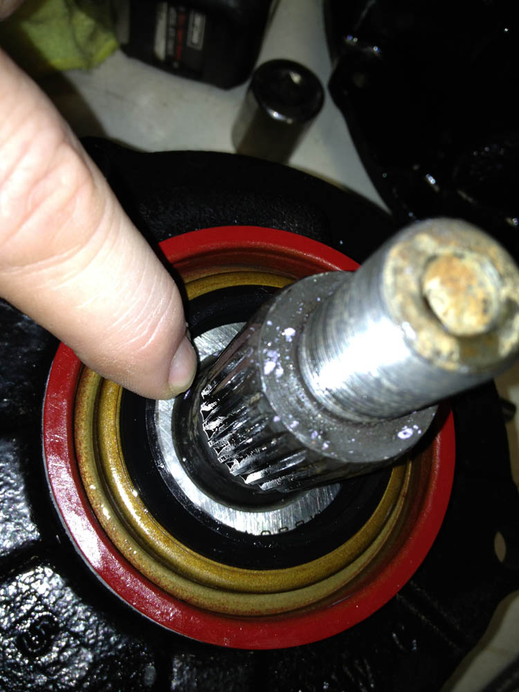

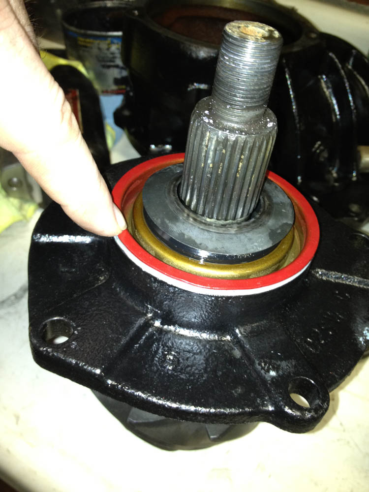

First one is I made a mistake and forgot the oil slinger that goes between the pinon seal and the outer bearing. I will more than likely tear up the seal if i have to remove it. Is this slinger neccesary? I know its there to keep the oil off the seal (and leaks), but just wondering.
Second question - When i put on the outer bearing I did not have to press it onto pinon. It wasn't exactly loose but its not hard to take on and off. Is this a problem? I assume the crush sleeve will load up the two bearings in between the yoke and the pinon end. But just wanted to check.

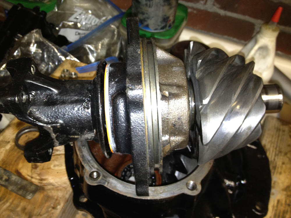

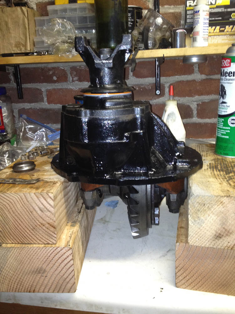

ok I tried what you all suggested however Iam a bit stumped at this pooint.

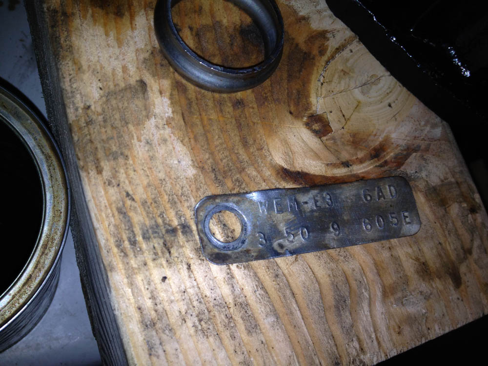

I'm not sure if I have the wrong crush sleeve, the new ones i have happen to be used, or maybe for some reason have a different rear end? maybe a medium duty? Maybe I got the wrong rebuild kit? (dont think this is the problem as everything seems to fit together - besides the pinon preloading issue.

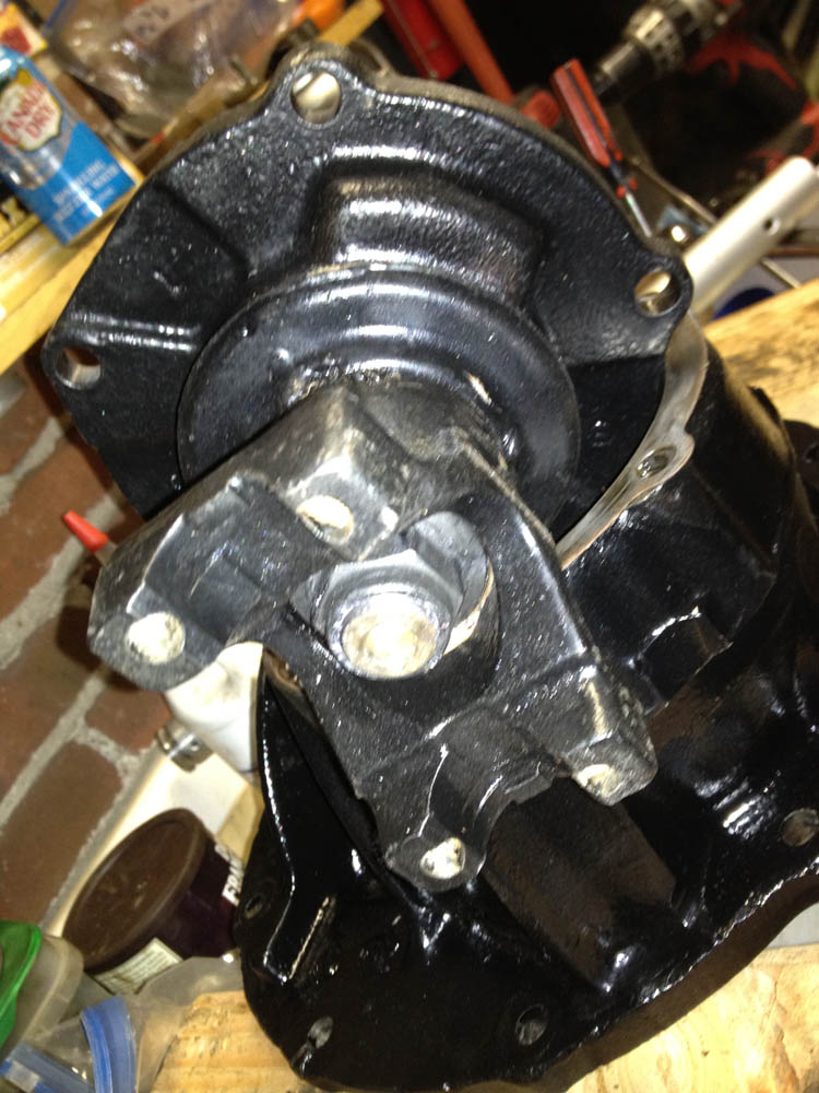

Problem iam having is with the pinon assembly. I removed the seal, put the oil slinger back on and then installed the new seal. I put a new (or what i thought was new) crush sleeve on, the yoke and then tightened it down until i had almost no movement along the pinon itself.. however the pinon holder spins almost freely with almost no resistance... I have cranked down on the pinon nut (over 150lbs) and it wont tighten. so this leads me to believe for whatever reason the cush seeve is either the wrong one or is used. The thing is i had or had two brand new ones... they both act the same way.
I have been really careful putting everything back together. The bearings are in the proper orientation, the seal is on good, the crush sleeve is int he proper place on the pinon and I cleaned everything really well.. but i cannot preload the pinon no matter what I try.
Right now iam going to order another crush sleeve. maybe for whatever reason mine is wrong or was used.. it came in a kit so i find that a bit far fetched but stranger things have happened. I have included a few pics from tonight including the rear tag for the axle.. any ideas?
The ford shop books approach it a bit differently. I would be happy to scan the pages in if that would help but I assume one ford 9 inch is the same as the next so its not like there is something so special about mine that it wouldn't work like everyone elses...

ok i think i got it.. got tighter and made very small adjustments. I used my inch pound breaker bar set on 12 to get a feel for it.. and stopped when i was close to 21... was afraid of going any farther....
-Are you using a dial type tourque wrench? Just an FYI A regular tourque wrench wont work. I would try to get it a tad more, the reason being is that the seal itself will create some resiatance as well. When I do a D44 I set the preload without the seal first to get it dead on but with a crush sleeve its hard to do it that way but the seal will indeed create some resistance and make sure it is lubed up with oil good on the yoke and seal to help out.
So it should have some resistance, when you turn it correct? its not easy to turn but isn't too tough with one hand...
-Yes there should be some reistance.
I put the pinon in the housing and did a quick setup for now and it seems hard to turn. I have to grab the ring gear pretty good to get it to turn.. its not easy. Sound about right?
-Yes

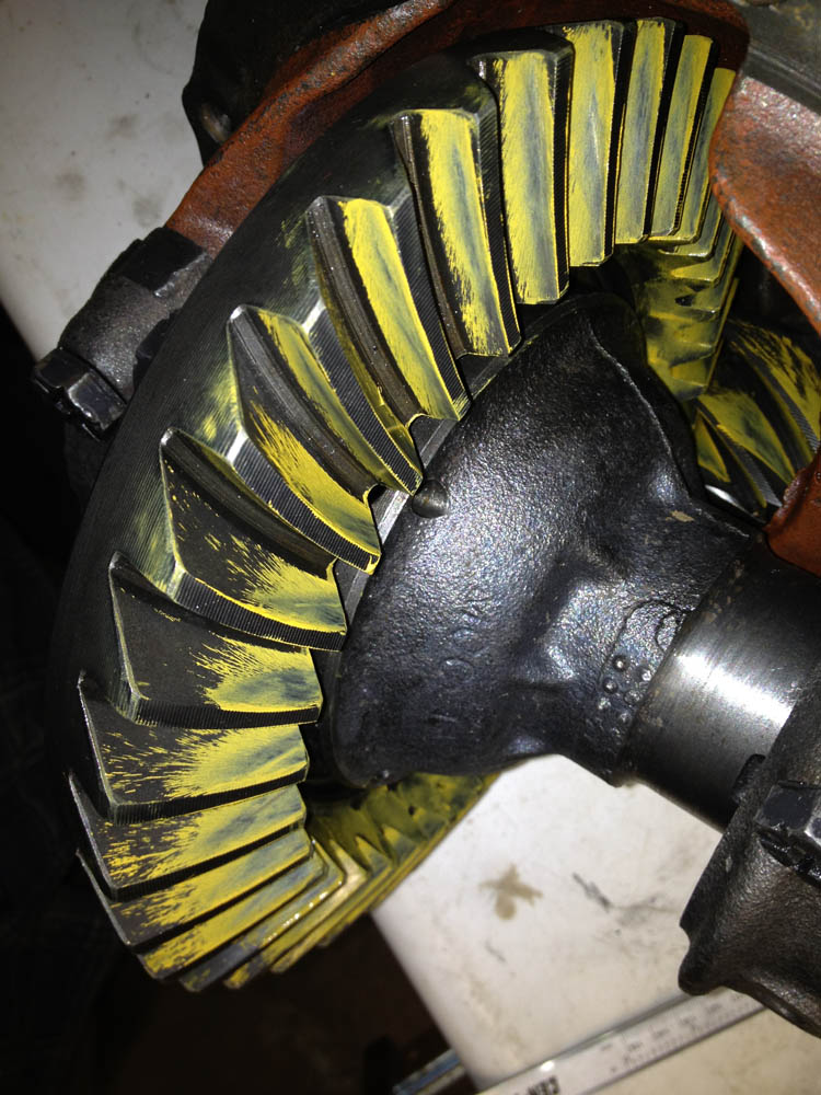

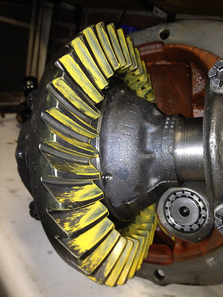

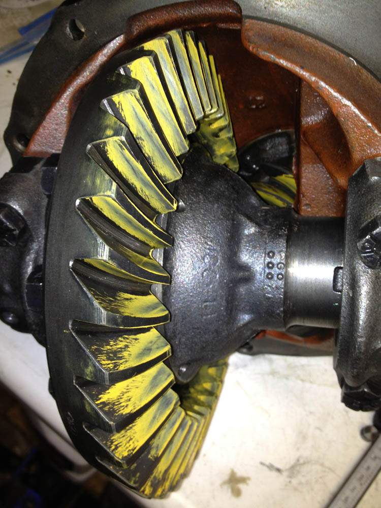

ok so i have the backlash at .010 whch is right in the middle of what the book states.
I put marking compound on the teeth and ran the ring gear around both ways a bunch of times.
This is the pattern iam getting.
I read and i was told that i only have to pay attention to the coast side of the pattern when reinstalling the old ring and pinon, which is the slanted side of the tooth.
If this is the case and Iam reading this correctly i will have to move the Pinon in toward the ring geat.
I reused the old shim so not sure why its off so much.

According to my shop manual this is an acceptable pattern. Even if I ignore the drive side since they are use gears I think it looks pretty good.
Maybe move the ring gear away from the piƱon a bit. Which undoing now.
