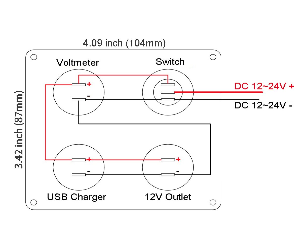

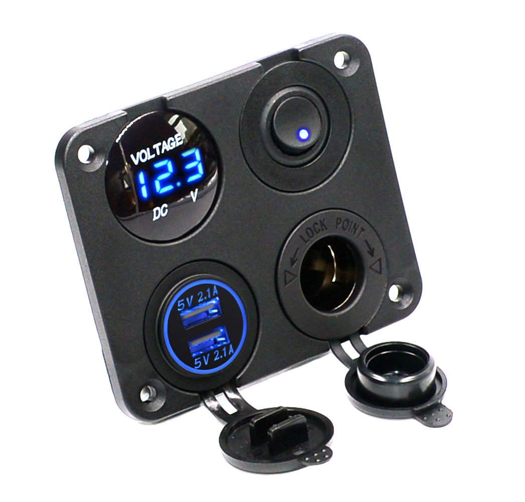

Post USB/Voltage/12V/Toggle Panel
Anyone tried one of these bad boys in their dash? It's dimensions are close to the OEM ash-tray but I'm not sold on cutting the dash as mine is stock.
https://www.amazon.com/Cllena-Charger-V ... DGAZH&th=1

Post Re: USB/Voltage/12V/Toggle Panel
That looks appealing! They have some other items as well. I need to do a nicer switch panel in mine, but I do want to include a USB charger as well!
why not mount it in the glovebox?
Yea, it could really go anywhere...along with their other models that are smaller.
I would like to find one with two sets of USB outlets instead of one and a lighter socket which I have no need for.

I received mine and it's constructed well. They panel is customizable as the individual units are held in place with a large nut. Also, each set of wires has a fuse.
I'm returning mine as I ordered the double unit (not quad) and was going to install it for the rear passengers but I don't want to drill 2 massive holes in the upper fender. I think the quad unit would fit perfectly in the ash tray spot.
