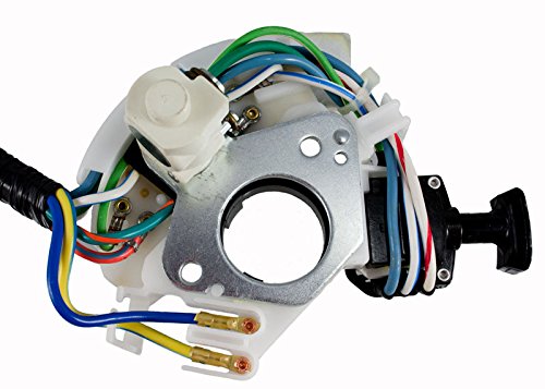

I have tried that in the past with no luck. I appear to be missing some parts as the assembly is a bit too loose to transfer any movement to the arm with the teeth on it. But since I know now what needs to happen, I can probably adjust it with a screwdriver.
As to the signal, it appears that someone has put the repair kit on it in the past as there are two wires that appear to have been soldered and the covered in liquid elec. tape. Bu pushing on these wires, I could get my dash blinkers to work intermittently, but after messing with these wires for a while, I can no longer seem to get them to work at all. I tried jumping wires to bypass the bad spot and I must not be doing it right, or just need more hands to hold wires in place.
The part number I need appears be to D8TZ-13341-A, which Rock Auto has for $69. A repair kit is $10.

I called Shee Mar, a Longmont co. and spoke with a guy there who got me going in the right direction. He says I need the SM61F for the 78-79 truck. The 50 series has a different mounting pattern, so I couldn't get by cheaper. Anyway he also said rockauto was the best price, to which I confirmed (brand says OE pro).

JD, it is indeed a tilt column from a 78/9 F150, so that would be the correct replacement part. The bolt you took out of one side and the thing you broke on the other side are the things that allow it to pivot, you push the signal switch away from you to make it tilt.
The correct pivots look like a threaded, screw in plug, similar to what guys put in the back of 351W heads to block the air ports on a smogged engine (but smaller). That crack in the bottom might be an issue as well, can't really tell from the pic.

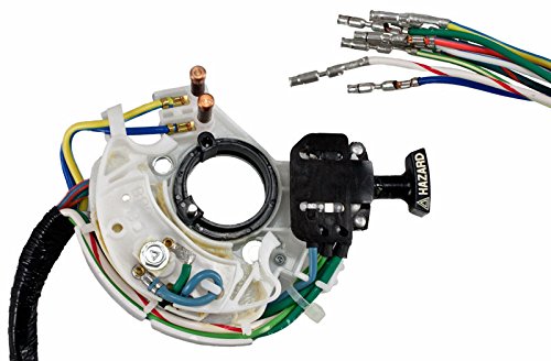

With the help of my son, we converted colors to numbers and I labeled all the new wires accordingly. Plugged it in and...nothing. Urgh! So I call Shee-Mar and the guy there said to check the flasher. I unplugged it and plugged it back in and I hear ticking...hmm. Victory! I wonder if this wasn't my issue all along??? O-well got a new turn signal switch out of it and after troubleshooting one front light connection, they are all working! Now I am not so obviously illegal.

So I lost my blinkers again. None of them work. E-flashers work with both my old and new flasher. The signals worked intermittently, and it seemed I could move the flasher and they would work again for that trip out. Recently that stopped working. I unplugged the connector from the e-flasher switch and made sure it was making a good connection there.
What part should I throw at it now? Could it be the switch mounted behind the e-flasher knob? Strange that they will all work, but not independently.
