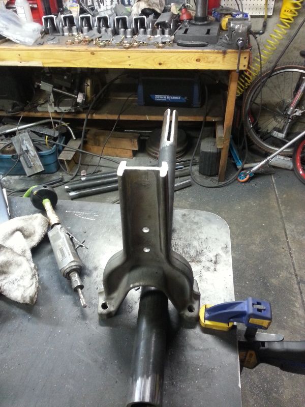

Post Re: Lars Bars Build Day/February Breakfast-DATE CHANGE
here it is
[attachment=1]100_0670.JPG[/attachment]
Thu Feb 19, 2015 11:04 pm
Yeah, that's bent. They can be heated and bent back, and I've got a torch. Some folks have done this for additional tire clearance. I'm honestly not sure how it'll affect overall strength. My initial thought is that it'll be fine, as we're going to heavily reinforce it with a big chunk of DOM tube, but I'll let others chime in. Given the low cost of arms, I'd track down a straighter one, but I'm anal about stuff like this and have the tools around to build arms whenever I want.

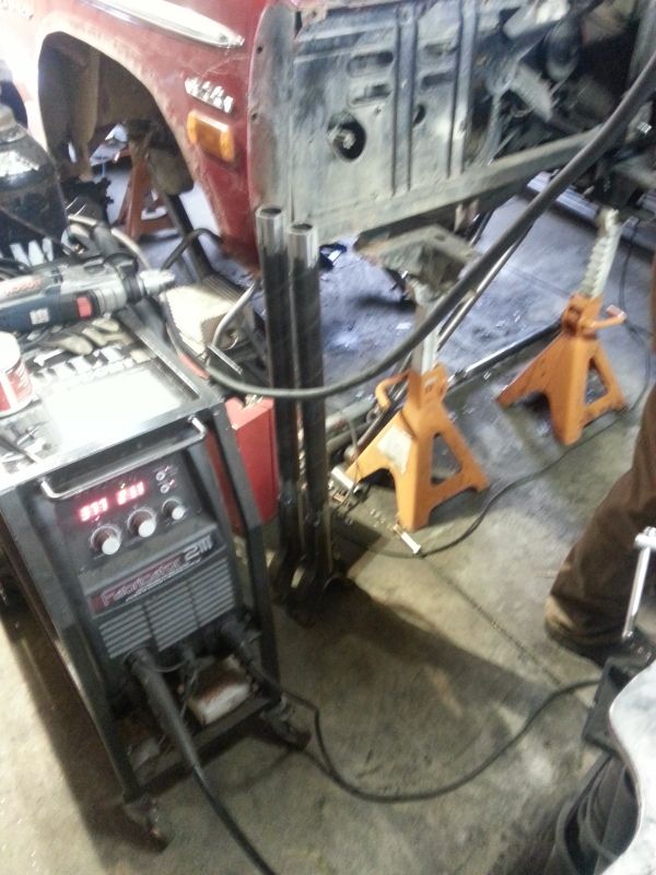

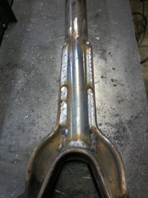

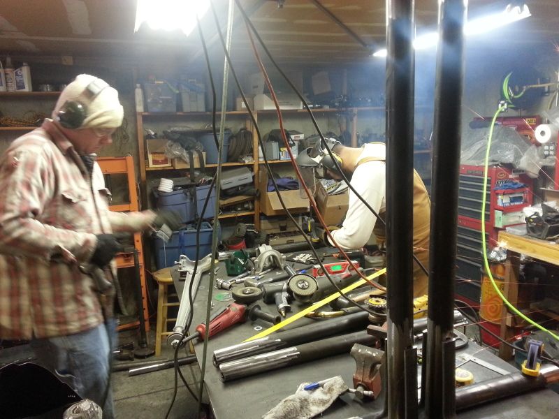

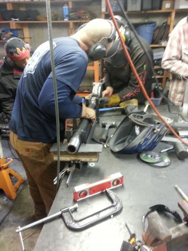

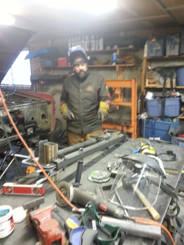

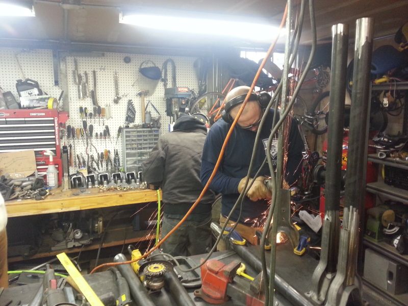

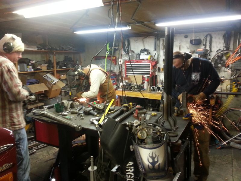

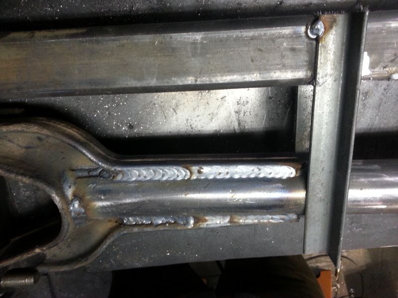

OK, now I'm in front of a real keyboard. Very successful build day. We got all of the tube cut and slotted, and most of the present radius arms cut to size. At one point we has 3 grinders, the plasma, and the chop saw running at the same time. 3 sets of arms got fitted and tacked or finish welded. The jig was a resounding success. I'm pretty sure we could knock out a set in an afternoon at this point. There is some fitting work to be done on the remaining arms, but it won't take a huge amount of work to get them completed. My wife thinks I have a sunburn from plasma cutting for an hour or two.

Like everyone said cut, grind, grind, grind, grind, fit, grind, grind, fit, grind, grind, grind, grind, fit, jig, grind, grind, grind, grind, fit, jig, tack and Im sure a lot more in there. Was a very good day. We got a lot done. One thing we know is the next ones will be built on a mill. Would save a lot of time and grinding. Welding them up uses a lot of wire. But we have one set fully welded except for the bung's.

ZOSO saves the day with pictures! Had a great time and learned a bunch on this project. The jig was added to and performed well, it'll be an asset to future builds.
Mon Feb 23, 2015 8:23 am
One additional piece of info: Ideally these should be left to cool in the jig after finish welding. Rob's stayed dead straight left to right, but we had to do some filling at the top of the tube due to the degree of camber we added in. It added roughly an additional degree of camber due to some very slight warping of the structure. He'll just need to take this into account when picking the shims, but I think that keeping the entire setup clamped to the backbone of the jig would have lessened the warping. Ultimately, building some way to solidly clamp the end of the tube in the jig is likely a better solution than the c-clamps we were using, as it'd keep things from coming loose as we roll the jig to weld each side.

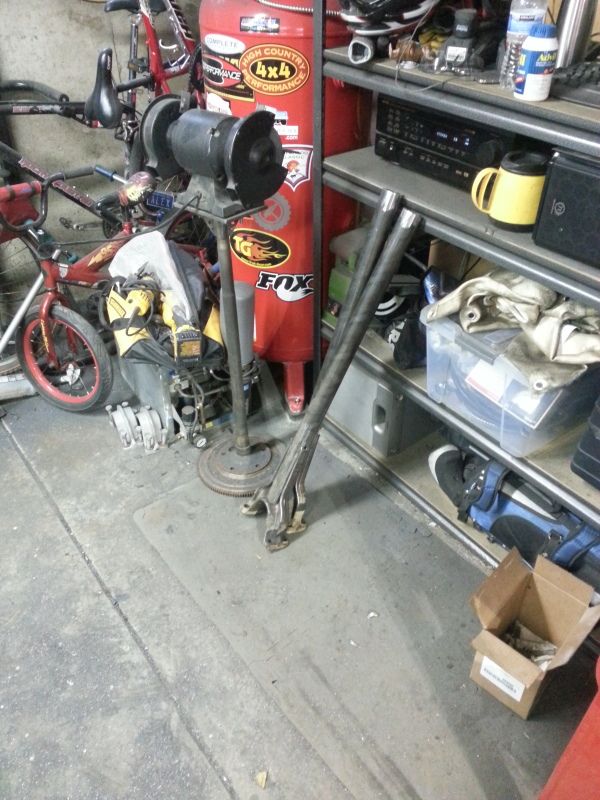

I've got the pieces and am leaving it up to their owners how they'd like to proceed. We don't have plans to re-do the tech day at this point, but I'm happy to help folks that need it. For your stuff, the arm that's tacked needs minor tweaking to fit and finish welding. The other arm has been bent, but still needs to be notched, fitted and welded. Happy to help you get it finished up if you want to come over.

Yes, although we only bent Eck's arms. After more conversation with Digger there was a decision to go with straight arms since the bend didn't add much and make the fabrication and alignment more complex.
