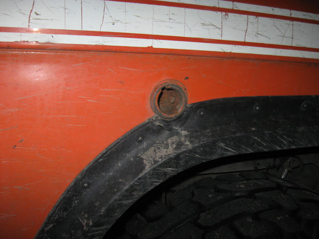

Joined: Sun Oct 10, 2010 11:33 pm
Posts: 231
Images: 5
Location: Greeley, CO
Post Re: Flare install tips
Here is a picture of the WH Warflares on Jonah's Bronco. We just ground out a small cresect for the filler tube, cap clears the flare. I think we used a cut-off tool to trim the opening.
