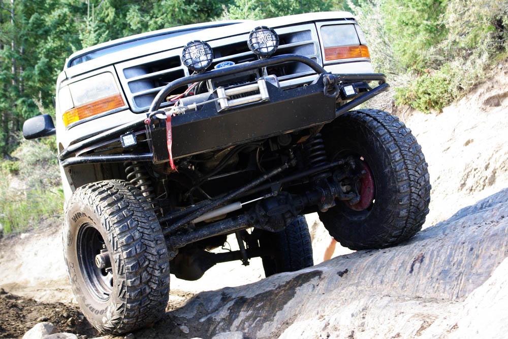

Landshark - those little LED Offroad lights look awesome!

Yeah, the Dually LED's are awesome! I bought a set wide beams for my truck and I am probably going to sell my truck, so I need to figure out what to do with the pair I have. I could put them on the bronco, but I want a true flood beam for that, not a low & flat beam.

the funny thing is I have used those lights on the front in the last year a total of maybe 4 times.. glad I had them, but i dont do much night wheeling.. they get used in the summer for camping however.. and man they can light up some stuff in moab on a dark night...
